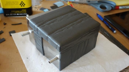

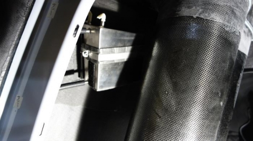

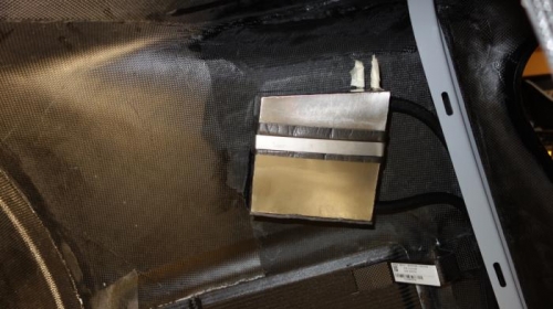

Brief Description:  Mounted Secondary Fuel tanks
Secondary fuel tanks are to keep constant fuel flow to injectors when airplane is in an uncoordinated turn. Mounted one one each side of the fuselage in the baggage compartment. Plans call for strap to hook over mounting bracket and then held from slipping off with Velcro tape but I riveted the tank strap to the mounting bracket to make sure it doesn't s come off.
