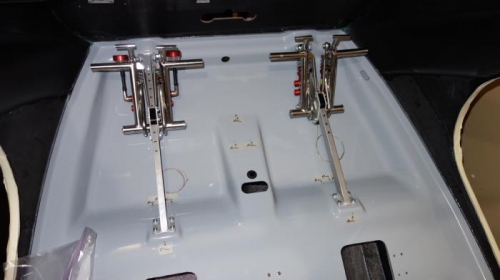

Installed Rudder Pedals
Drilled holes, installed rivnuts, used super glue to make sure they don't spin if I have to loosen them after locktite has been used and then bolted in rudder pedals
