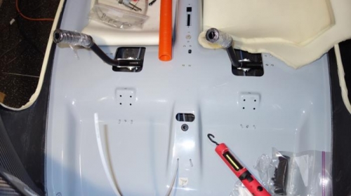

Date:  5-30-2015
Number of Hours:  6.00
Brief Description:  Installed then removed elevator/aileron control sy
Drilled mounting holes and installed main elevator/aileron control arms in the fuselage floor. This was a tight fit and I wanted to see how much room I had for brake lines, electrical wiring and fuel lines. I can't access anything under the fuselage floor with the main elevator control rod in place, so now that I have a good idea where everything goes, I removed them and am going to start working on the rudder cables, brake lines and fuel lines.
