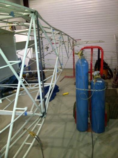

Bearhawk is on the spit! (rotasserie) to make welding so much easier.

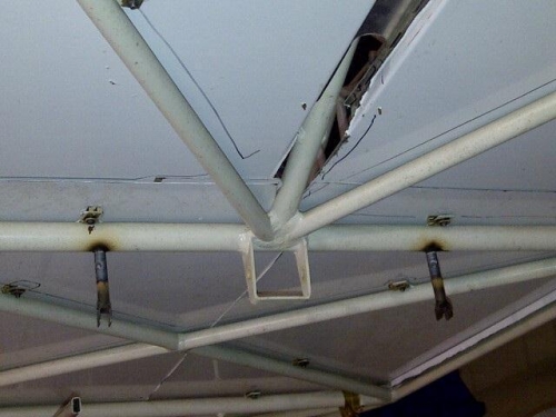

Bottom Standoffs - Early fuselages (#59) have too short of stand offs, Avipro sent some longer ones. Finally getting them installed (that first weld on a nicely painted fuselage is the hardest).
On the top, the 0.5" x 0.5" x 0.035" tube was installed over two shortened standoffs. Tack welded as it is refernce for everything else. I like captured nuts (rivnuts) inside the tube, but for long term maintainance a simple screw and nut is better (helper inside, to hold the nut)
