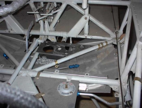

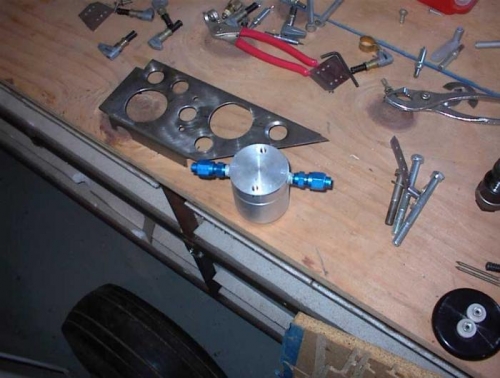

Brief Description:  Gascolator mount - now from 0.071" 4130
I had made a gascolator mount from aluminum.
More I thought about the weight of the gascolator, and the mount, the more I didn't like. Probably would have been fine for 20 years.
Finally realized the OA torch will have to do some things on the fuselage (battery mounts, skylight, brake hardline attach - etc). Might as well make a steel mount and weld in place.
