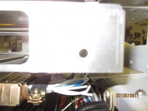

Brief Description:  test fitting radios in racks in panel
Dick Isherwood stopped by the help.
I worked with the radio trays in the panel, using screws in the holes in the angles to make sure that the angles were placed properly and the holes for the radio tray mounting were correct.
Put the back plate and receptacles on the ICOM and on the PMA 8000b audio panel.
Riveted the angle pieces that hold the trays onto the panel with 4.5 rivets countersunk on the front of the panel.
