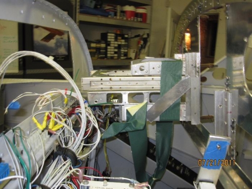

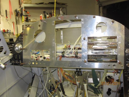

Riveted nutplates to the rear of the panel for the attachment of the EIS and GRT Sport. Riveted the small angle pieces that will secure the Airgizmo dock for the 396.
Attached the panel with the radio trays and put on the top skin to make sure the panel was in the correct position. The rear of the radio stack touches the dimmer module.
Removed the dimmer module and the radio stack seems to fit withou interference.
Removed the topskin and used a piece of angle to secure the panel to the brace ahead of it. I should actually attach it all the way to the firewall to be sure.
