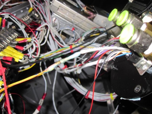

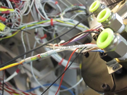

I installed the PC connection harness to the D6 EFIS. Pin 22 on the D6 is the serial in port and has a dual role of accepting GPS data to give the D6 backup attitude information in case the pitot tube becomes inoperative. That same serial port is also used in the PC connector to upgrade firmware. Therefore I spliced a line that runs from the Garmin 396 GPS blue wire, then to a yellow/blue wire,into the orange wire of the wiring harness which goes to pin 22 on the D6. I must remove the GPS connection when new firmware is uploaded.
