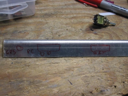

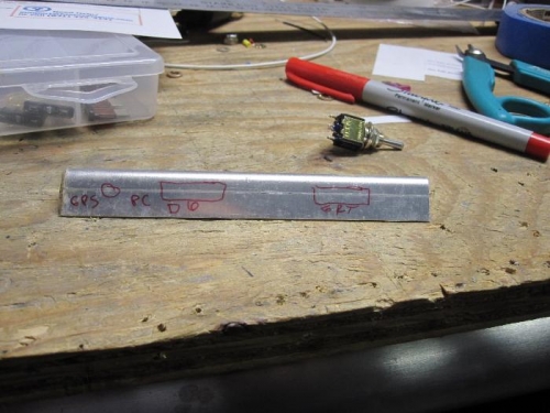

I think the solution is to have a small switch that will switch the input to the D6 serial from GPS to PC wiring. I played with that tonight and cut a piece of light angle, just over 4 3/4 in long which can
mock up usb panel
mock up usb panel
