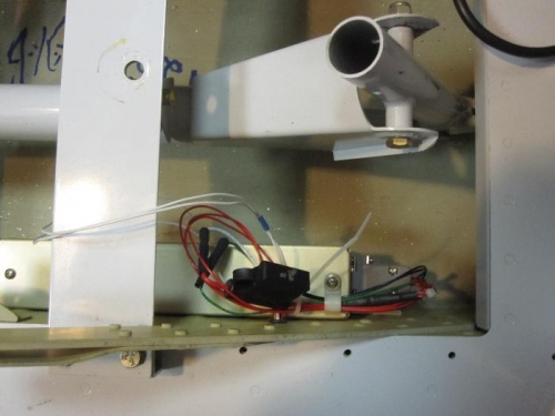

Worked on the installation of the G meter/clock. I ran a white 22 awg wire to the battery compartment to attach it to the battery and to the 12v in on the G meter/clock. Then I noticed that there was already a small red wire there in the battery compartment. The red wire is a backup power wire for the D6, which I am not sure I will use.
I will have to sort out a couple of things before I finish the G meter installation.
Back up battery wiring
