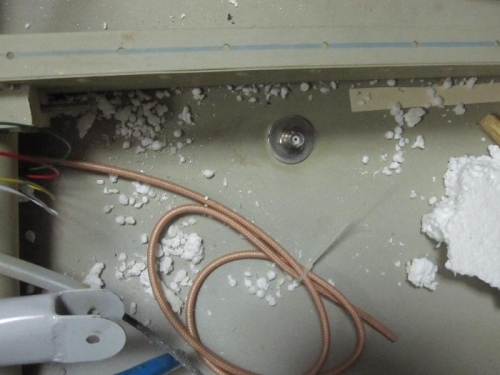

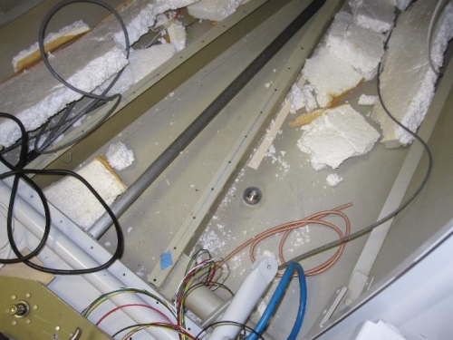

Drilled hole in airframe and installed TED transponder antenna. Cable not yet connected. Dr. Lori Alvarez assisted in this.

xponder ant mount
xponder ant mount
