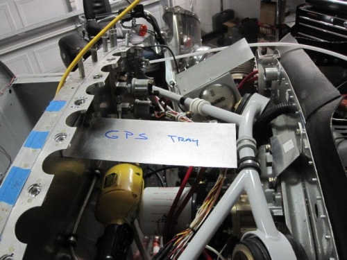

Brief Description:  SL30-GRT EFIS-GPS antenna tray

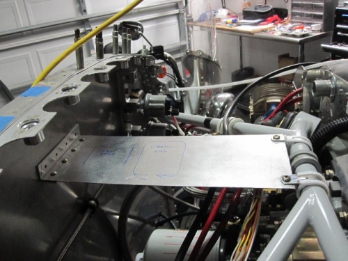

I attached the GPS antenna tray at the forward end with adel clamps to the engine mount. The aft end will attach to the firewall with stainless steel hardware.

GPS tray attached
GPS tray attached
