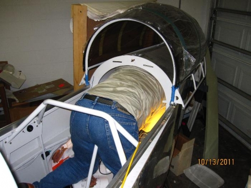

Dick Isherwood assisted tonight and remained until 11pm.
We reviewed the GRT autopilot pitch servo installation instructions which do not exist. GRT said to look at Dynon and Trutrack for the install info because their servos are identical. Dick and I determined how to mount the unit. The servo will be on the port side of the aircraft. It is better to run the wiring down the port side because the starboard side is pretty much full.
I removed the wiring I had run up the starboard side and re ran it up the port side. We rant it through the service loop and prepared it for connection at the GRT unit. Then we reviewed the documentation and realized that the black ground wire did not need to be run forward and could be connected near the servo t
