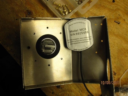

Labeled and Installed COM 2 antenna wire using RG 400.
Relocated the dimmer module to allow room for the radio trays.
Attached the three GPS antenna, the Garmin 396, XM weather antenna/receiver, and the Glisson antenna supplied by GRT....to the antenna tray that will attach to the firewall and house the antenna under the cowl. After it was in place I realized because Dick Isherwood pointed it out, that the aftermost antenna was shielded by the overhang of the bracket for the skybolt fasteners that attach the cowl.
Cleaned up the panel in preparation for applying the carbon fiber.
I eventually scraped this antenna mount idea and built a tray.
