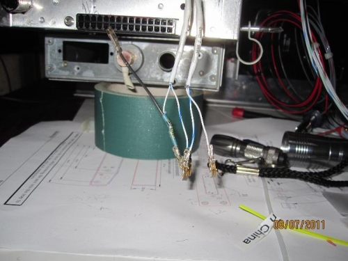

Brief Description:  wiring ICOM A200 radio
Dick Isherwood brought over the molex crimper. I used it to complete the wiring from the PMA 8000b audio panel to the ICom A200. I also made the jumpers required for pins 11, M, P and 13, using 20 awg wire.
Made and installed the power connections to pins 14 and R using 18 awg wire.
Next I will make up the power ground harness that grounds pins 6, 15, F and S.
I was frustrated by the fact that the pins were difficult to get to engage in the holes. It took a long time to figure out that it seems that the flange on one side of the connector goes down on the top row, and up on the bottom row. At least i think that is the case.
Messing around with the molex connectors took a lot of time, and I ruined several of the connector.
