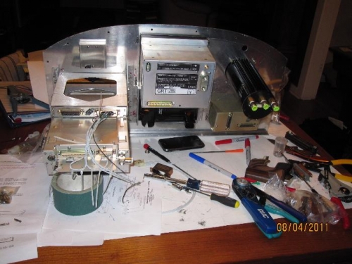

Date:  8-4-2011
Number of Hours:  4.00
Brief Description:  wiring audio panel to SL 30
I began wiring the radio stack. Taking things slowly and carefully. The second two conductor wire that I installed was in the wrong pin holes. The first removed rather easily but the second took at least half an hour to get out. The plastic extractor broke and the wire pulled out of the pin. I had stopped by radio shack on the way home from work and bought a metal pin extractor. By the time I finsihed removing the second pin, the new extractor was bent up.
I finished installing the Com 1 audio, Com 1 mic and Nav 1 audio wires. I stopped before beginning the installation of the Com 2 wiring.
I had to shorten two of the wires considerably, requiring the removal of the labels.
