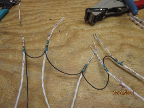

Went to skycraft and determined that the 24awg sheilded wire that I bought yestarday was indeed mil spec 275000 which is specified as the correct mil spec for avionics wiring. I also bought some solder sleeves.
Made up 5 sets of 2 conducter wires to connect to the SL30, PMA 8999b audio panel, and the ICOM A200 radio. I used #20awg black wire to daisy chain the shields together. I used the solder sleeves to attach the daisy chain jumpers to the shields. It worked very well.
I crimped tiny pins onto the 10 wires for com 1 and com2 audio and mic and nav audio. All those will go into connecter J1 on the PMA.
