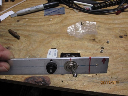

Brief Description:  wiring, alt field, tach switch, mock panel

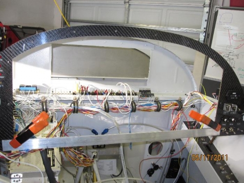

Made a mock panel strip that mounts across the bottom of the panel area in place of the panel. I drilled holes for an alt breaker and the SPST switch that will select the mag from which a tach reading is sent to the EIS box.
Ran and attached:
Wire from the main bus to the alt field breaker.
Wires from the emag and pmag to the tach selector switch
Wire from the tach selector switch to the EIS box
Attempted to install the 4.8v block but the #8 screws I had were too short.
