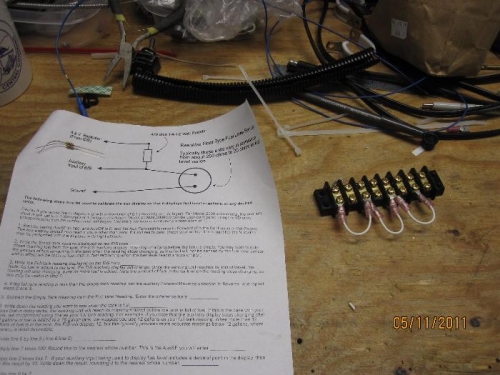

Made up a junction block for the 4.8 v excitation wires from the EIS to the fuel pressure sender and fuel level senders. I will add a resistor for the amp hall effect sensor later if it is needed.
I used an 8 section strip divided into 4 parts of 2 sections each. Each part has a 4.8v input jumper from the EIS, a resistor of the appropriate value, and a place to connect the appropriate aux wire from the EIS and to the destination (fuel sender, level sender or amp sender).
