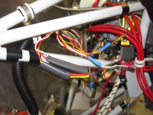

Brief Description:  EIS wiring
Installed an adel clamp on the motor mount where the wiring comes out of the fuselage. Attached spade connecters to the 8 connections for EGT and CHT on the starboard side of the engine. Ready to shrink wrap those connections.
I realized that not all the wires in the bundle need to go forward of the firewall. In fact, most don't. I prepared a diagram of the wiring showing all the connections. I actually pulled the gray wire for the OAT connection out of the bundle and back into the panel area.
Worked on determining which AUX ports will be used for what purpose. I am still confused about whether some of the functions, such as OAT which has its own dedicated pin, takes up one of the 6 AUX ports?
