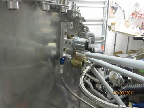

Brief Description:  manifold spacer - oil and fuel sensors
I purchased a piece of aluminum from Skycraft, along with 5 1/4 x 20 bolts 2 1/4 inches long for the FAB connection to the fuel servo.
Out of the aluminum I made a spacer to stand the manifold off the firewall so that the oil switch could be installed in the side port. I installed the fuel and oil sensors and the oil switch. I also attached the fuel pressure hose.
