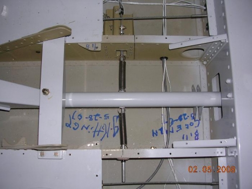

Installed the second spring on the roll trim. Worked on the linkage problem with no sucess in fixing it. Lowered and raised both attach points for the control column mount, adjusted the length of the pushrods, no joy.
