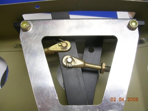

Brief Description:  throttle and mixture cables attach to quadrant

I installed the cables onto the quandrant mounting bracket and attached the ends to the throttle and mixture levers. The cable ends are screwed all the way into the fittings attached to the levers. One of the cables had only a couple of turns of thread available at the quadrant side of the mounting plate.
