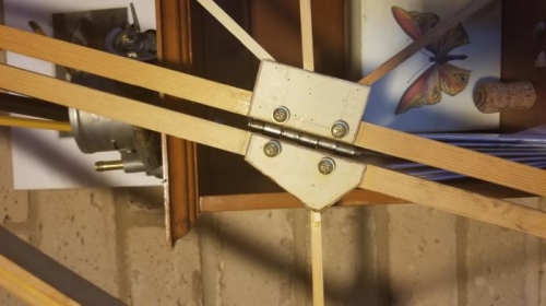

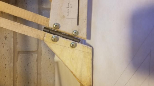

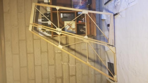

Brief Description:  v-stab - finished drilling and assembly
Finished hinge fitment on vertical stabilizer and rudder. Space between t/e of vertical stabilizer and rudder leading edge is 3/8" at top and 13/32" at bottom. Angle of travel for rudder is symmetric to approximately 30 degrees with no binding in hinges.
Cut slot for rudder horn on RH of rudder.
Next step is to varish. Will do so while working on horizontal stabilizer
final fitting

lower hinge
lower hinge
upper hinge
upper hinge
