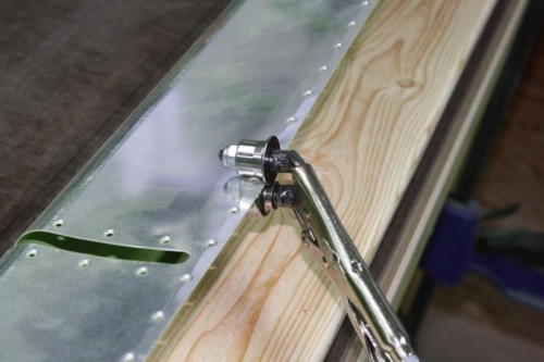

Step 1: Rivet R-Flap Skeleton per the plans
Step 2: Reroll the the trailing edge of the inbd and outbd LE skins so edge lays down tight. Install LE skins on skeleton.
Step 3: In the cradle, install the top left skin and cleco into position, mark rivet sizes on skins and check for straightness.
Bottom shop head a little over driven but ok.
Noticed I needed a little more edge once fit checked.
Edge pulled down ok.
