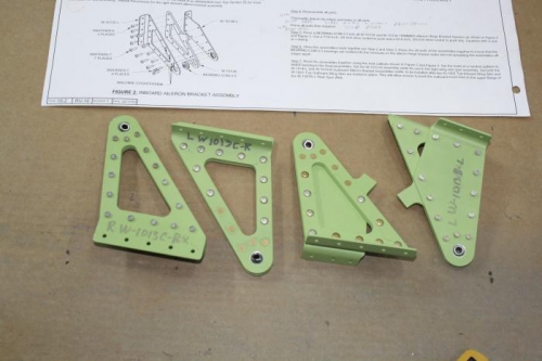

Brief Description:  Assemble Aileron Brackets, press Brngs, Rivet Assy
15-2:
Step 5: Pressi Aileron Bearings into Aileron Hinge Bracket Assemblies in vice as indicated in instructions.

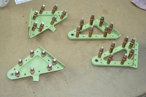

Step 6:Reassemble Aileron Bracket Assemblies and check that bearings are centered and not spreading the assembly due to mis-alignment. Adjusted as necessary.
Step 7: Rivet Alieron Bracket assemblies as indicated
