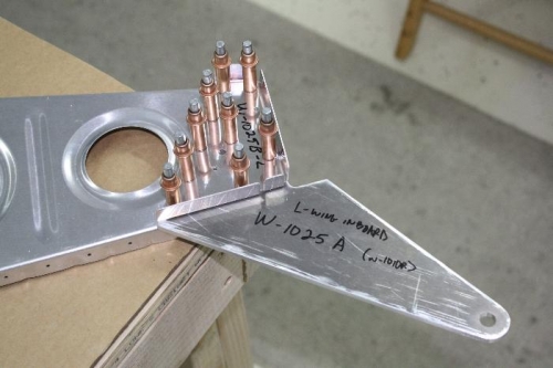

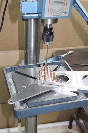

Step 9: Cleco and final-drill #30 L-Wing inboard wing rib, flap hinge bracket and hinge rib. Used the drill press to ensure square holes.
Step 10: Cleco and final-drill #30 L-Wing outbourd wing rib, flap hinge bracket and hinge rib. Did not need to ream the flap attach hole in all flap hinge brackets to 3/8 in as they were already done.
