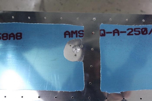

Step 3: Drilled hole for static source for both Side Skins to 1/2 inch per Cleavland Static Ports.
Back drilled three #40 holes for mounting Static Ports.

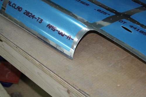

Step 4: Debur & Scotchbrite Stiffeners & Skins and rolled lower edge of Left Skin. I used the Cleaveland Edge Forming Tool that has a vice grips handle. Worked great.
Tim's sander trick worked great!
Rolled Left Side Skin Edge
Cleaveland Static Port
