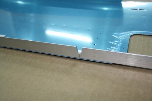

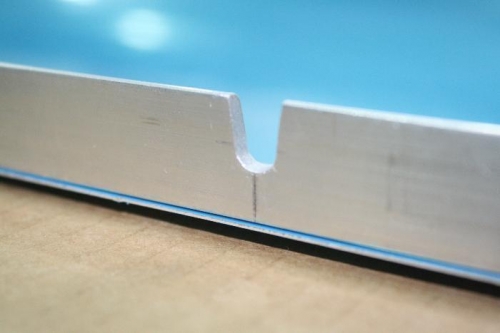

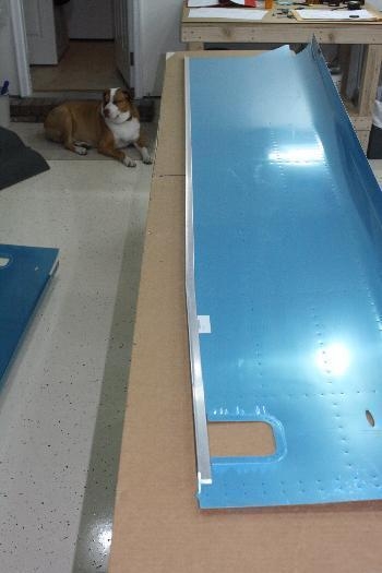

Manufacture Longerons
- Used AA6-125x3/4x3/4 angle to make Longerons: measured, cut to length, and removed material to accomodate Hz stab attachment bars.
- Bent the Longerons to match the F-1073 vertical tail cone skins.
