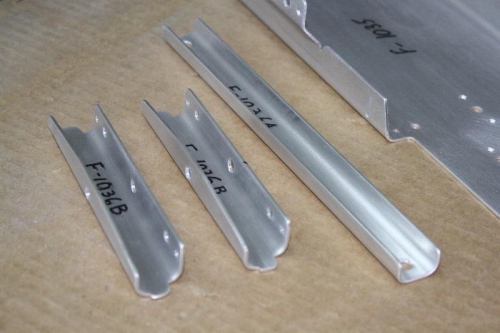

Step 6: Separate Battery Channel parts
Step 7: Final-Drill Battery Channels, used drill press on 1/4" holes and hand-held on the others.

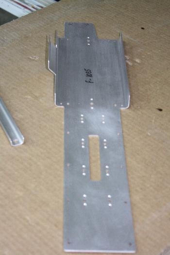

Step 8: Final-Drill Battery / Bellcrank Mount per the plans. Deburred hole, finnished edges, and scotch-brited surfaces.
I may modify the battery tray later to fit an alternate battery such as Odyssey PC925 as other builders have done. For now, these parts are ready for primer.
Battery Channels

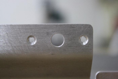

Right C-sink was a minor challenge
