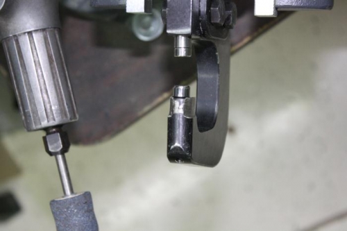

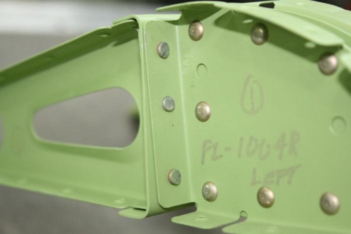

Setp1: Riveted per the plans and did most work with pneumatic squeezer. Had the grind the jaws somewhat to get on top of rivet head when perpendicular surface rivet impenged. End rivets were driven with long straight set and tungsten bucking bar.
Bucked these three end rivet both sides.
Mod to pneumatic squeezer jaw for clearance.

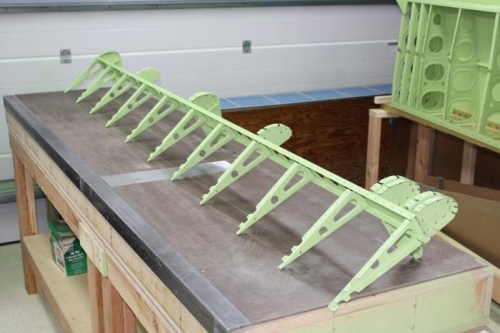

Left Flap Skeleton.
Left Flap Skeleton.
