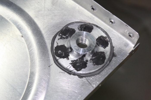

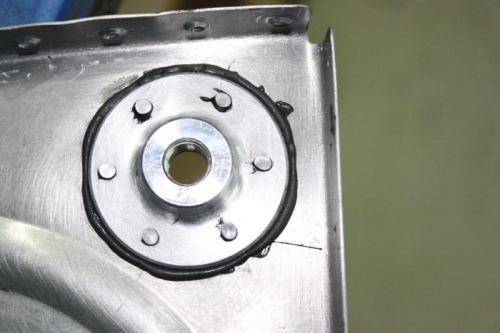

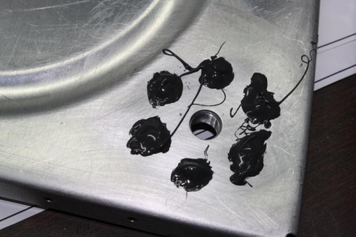

Trimmed a set of 470AD3-4.5 rivets for the Xtended Range Flange riveting. Prosealed holes and used hand squeezer to set rivets. Prosealed manufacture and shop rivet heads.
Set rivets.
Outside tank outer rib.
Inside Tank fitting.
