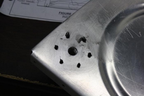

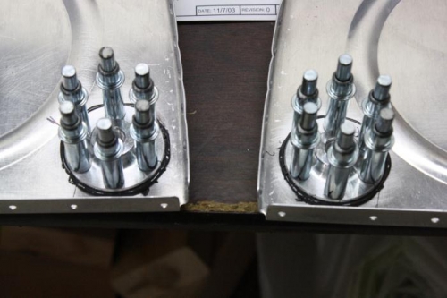

Scotchbrite scuff, cleaned with MEK, and Prosealed Xtra Rng Tank Bungs to the L and R Tank End Ribs. Used extra Proseal to patch back side of holes previously sealed from inside the tank of inboard ribs. Cleaned threads of bungs with q-tip and MEK.
Rib outside of tank.
Rib inside tank
Rib inside tank

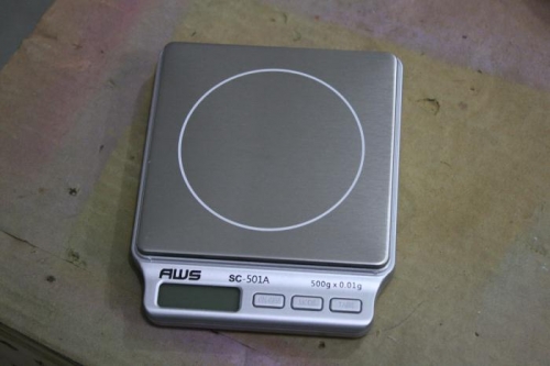

New scale used for Proseal, 0.01 g accuracy
