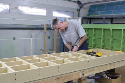

Summary: 3 compartments wide (8 13/16 in) by 10 compartments long (8 7/8 in)

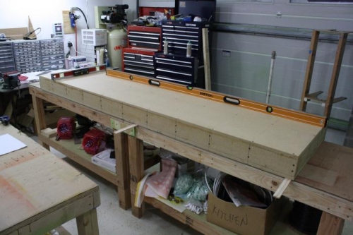

BIG heavy box, absolutly no twist/warp ( < 0.1 deg ) and only a couple of high spots that can be sanded down, on the order of 4 to 6 thousands of an inch (thickness of copy paper), according to the 6 ft level. Have set it aside, on edge, until needed. Now to finish the tanks.

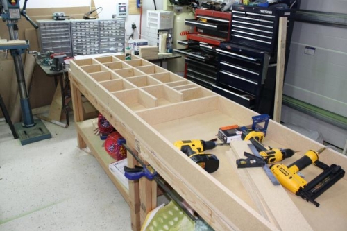

These are the tools I used.
Will have to measure the last two to fit.
Flip it over and put the bottom on.
