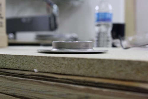

Step 3: Fit R-Tank Fuel Cap Flange. This one was in bad shape. The other one was fine and did not require adjustment. This one seemed to be over bent only on one side. I flattened and reshaped back to dimensions of 3/64 inch but found that still to be a bit strong on the contour so relaxed the dimensions slightly. I will recheck the L-Wing Fuel Cap Flange now that I have all this experience with the right one. Used the vise and my hands to bend the flanges.

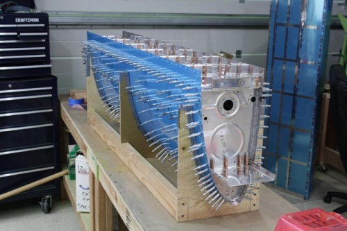

Step 8: Disassembled R-Tank. Machine countersinked Fuel Cap Flange part way until I broke my last 3/32 single flute countersink bit. Selected some choice words and informed the world I was not happy with this feeble product. But I like the results so I went on line and ordered 10 more with 3 backup 3 fluted countersinks that don't break as easily but do not do as nice a job. Stripped sections of blue vinyl off outside of R-Tank Skin along rivet lines. Called it a night.
The dorked fuel cap flange

Assembled R-Tank.
Assembled R-Tank.
