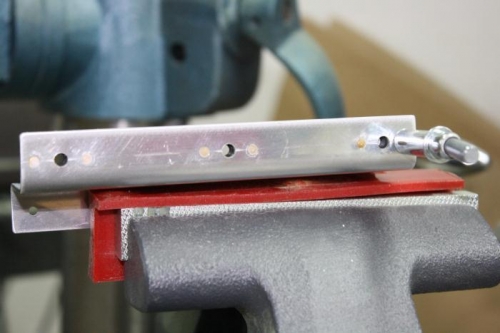

Step 1: Drilled nutplate retaining hole so Tank Attach Zees to #40, countersunk for NAS 1097 AD3-3.5 vs AN426AD3-4 rivets. Used hand squeezer to install rivets to Zee and nutplates.

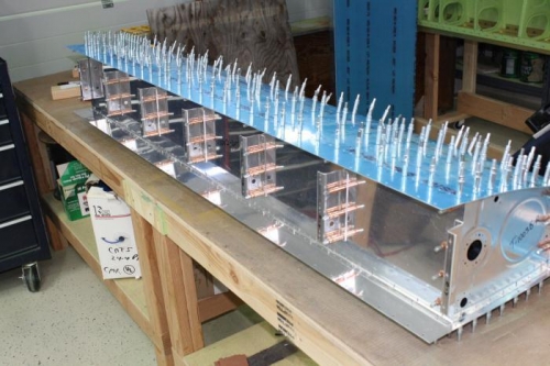

Step 2: Clecoed the Tank Inbd Rib-Aft to the Tank Skin and Attach Bracket per the plans.
Step 3: Clecoed the Tank Baffle and the Tank Attach Zee's to the tank rib aft flanges. Final drilled the all attach zee to tank baffle. I noticed after match drilling that there was an orientation to the tank baffle T-1002. There is an extra flange hole mid span of the bottom flange (got lucky). I did not see this called out in the plans.
Step 4: Clecoed Tank skin to upper and lower flanges and match drilled.
Step 5: Drilled all screw holes in the Fuel Tank Skin to #19.

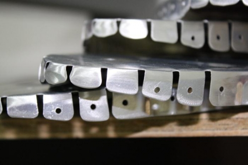

Step 7: Disassembled L-Tank. Polished rough leading edge of all ribs since noted some gouging and leading edge skin deformation, which appears not permanent once disassembled.
Used 1097 AD3-3.5
Used 1097 AD3-3.5
Left Tank Assembly.
Left Tank Assembly.
Polished leading ege of ribs
