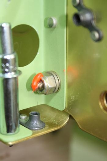

Manual Reference:  14-6
Brief Description:  Install and Torque L & R Wing Rib Bolts
14-6:
Step 1: Install upper and lower forward rib bolts to spar. Torque to 30 in-lbs and apply torque seal. The lower most inboard bolt, AN3-20A was a bit too long for this position on both spars for only one AN960-10. Plans say to add two. I installed one AN960-10 and one AN960-10L which seem more consistent with the length of the other bolts with one washer.
Torqued 30 in-lbs
Torqued 30 in-lbs
Two washers
Two washers
