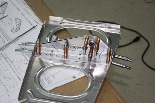

Step 2: Cut AA6-063x3/4x3/4x7 13/16 for right wing as W-1029C angle
Step 3 Cut .063 2024-T3 x 6 15/32 per dimensions as W-1029d spacer for right wing
Step 4: Cut .063 2024-T3 x 1/13/32 per dimensions as W-1029E spacer for right wing
Step 5: Clamp and drill W-1029A-R torque tueb suppor tbarcket and two spacers #30 match drill
Step 6, 7, 8: Assemble torque tube bracket and constructed parts with W-1010-L for right wing and match drill #30.
Step 9: Cleco and final drill #30 inboard flap hinge assembly for right wng.
Step 10: Cleco and final drill #30 outboard flap hinge assemblies (2 ea) for right wing..I missed the "repeat this process" step so had to build another for the left wing at this time.
14-3:
Step 1: Removed the flange an flange radius from the top and bottom of W-1011-R (left wing) and W-1011-L (right wing) per instructions using a band saw.
Step2: Removed the aft flang but not the flange radiuss from the W-1012-R (left wing) and W-1012-L (right wing) using a small dremel with fiber cut-off wheel.
