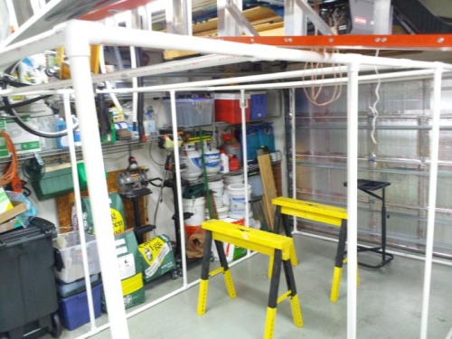

Brief Description:  Assembling the portable paint booth.

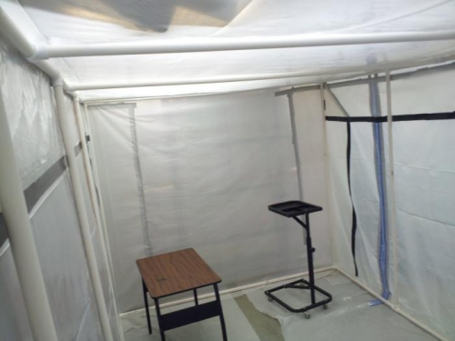

Constructed out portable paint booth using pvc pipe (no glue), 6 mil plastic, and gorilla tape. On one end we have a vent with a filter where the clean air enters the booth. On the other end we are constructing the 4 box fan setup that will suck out the contaminated air. The final dimensions are 12ft long, 7ft wide, and 6.5ft high.
The pipe frames.
The pipe frames.
After taping the booth together.

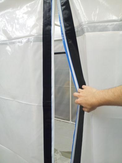

Zipper door.
Zipper door.
