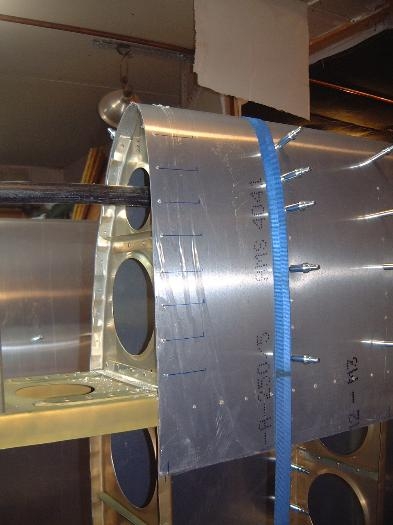

Brief Description:  Predrilled and began drilling the last right skin.
Today I finished predrilling the final right skin. I then installed it onto the skeleton and began drilling it.
I thought I would mention that I found an easier way (for me) to drill the overlap skins. I first drilled the holes in the already-installed skin. I then measured out 2" from the hole and made a mark. Once the new skin was installed, the line was transferred to the new skin and the hole was drilled in the new skin and through the existing hole. It worked much better for me.
Predrilling the overlap.
transferring the line and drilling.
