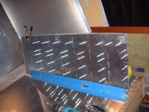

Brief Description:  Began to repair the 3rd left skin.
I decided to repair the short skin on the left wing before going on to the right skin. So step one was to form a new leading edge. I then removed the short 3rd skin and lined up the bottom edge of the already-drilled skin. I then clamped it to the new skin and drilled the bottome holes in the new skin. Because of the difference in distance due to the bend, I'll have to attach it to the skeleton to drill the remaining holes.
Re-drilling the 3rd left skin.
