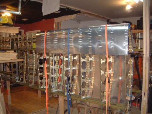

Brief Description:  Drilled the second left skin.
Today I began by predrilling the nose rib holes in the second left skin. I then placed it back on the skeleton and ratcheted it into place. I then placed clecos in the previously drilled overlap and aligned the nose ribs through the holes and drilled them.
Second left nose skin drilled
