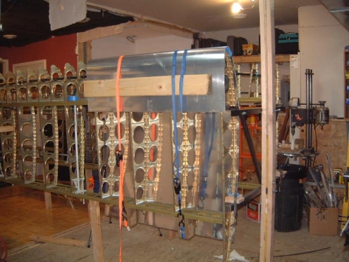

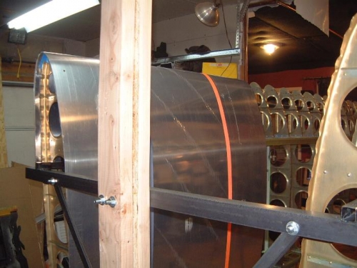

Brief Description:  Traced the left wing tip skin.
Today I placed the wing skin on the left wing tip end. I held it in place with tie down straps (not forgetting the wood blocks on the rear spars to keep from bending the skin). I then reached in through the lightening holes and traced the spars and ribs of the nose ribs and also traced the middle ribs.
Left tip skin tracing
