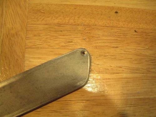

Next, I had 3 holes on the back ribs that needed to be dimpled because it was too tight for the squeezer. I figured I'd make my own die to work with the rivet gun and it worked well. I drilled a hole in a piece of 1/8" steel bar stock. Then I countersunk it to a depth to accept a -3 rivet. Then I polished all of the edges off of it.

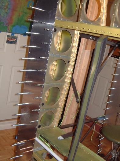

Finally, I installed grommets into the fuel line holes and installed the skin onto the skeleton. Looks pretty nice without the PVC coating...getting excited to get to riveting!
Homemade -3 dimpling die.

Root skin and grommets installed.
