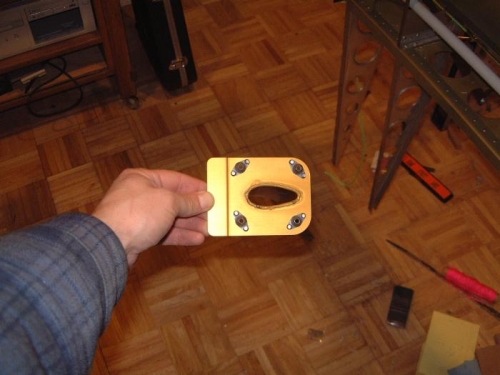

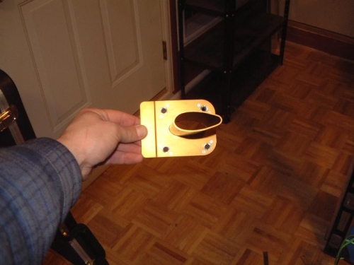

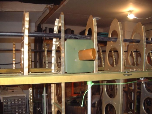

Today I finished mounting the pitot tube mount. I started by drilling and countersinking the lugs to the pitot mount mast. Then I drilled the holes in the mounting plate out to 3/16". I then dimpled them to accept a 10-32 flush screw. I then attached the lugs with flush rivets to the pitot mast. Lastly, I riveted the mounting plate to the nose ribs #8 and #9. Checking for fit came up successful!
This ends all major assembly items. The next step, when funds allow, will be to begin the skinning process.
Pitot mounting mast holes.
Pitot mounting mast lugs
Attached pitot mounting assembly
