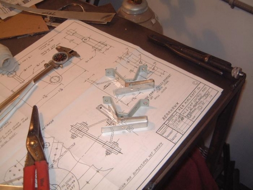

Brief Description: Aileron cable retainers and fairlead install.
Today I made a small amount of progress on the other aileron cable retainers until I realized that I don't own a 10-32 tap (for the retainer screw).

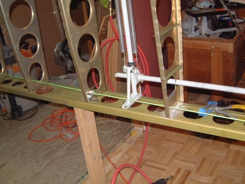

So I moved on to the aileron cable fairleads. I installed the root one on the left wing. I then measured the hole location and drilled them into the half ribs. Next I strung the aileron cable...ummm, I mean a clothesline from the root to the bell crank and marked the location of the other fairlead. I then drilled and clecoed the outboard fairlead into place.
