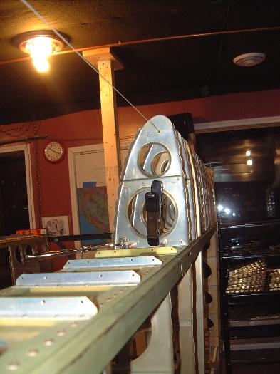

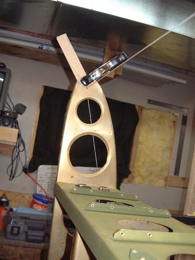

Brief Description:  Began attaching nose ribs.
Today I began attaching nose ribs. I am using the string method to locate the nose ribs and it's working quite well. A string is fed through the jig hole of the tip rib and centered in place with a piece of wood shim. Then the string is pulled tight the length of the wing and is attached to a hook that is in a 2x4 clamped to the angle iron. The ribs are then centered with the string in the center of the hole and the rib is clamped and drilled.
Tip rib with string centered
Root rib with the string hook
