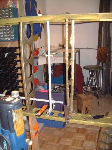

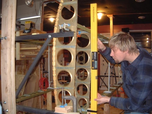

The next step is to ensure that there is no twist in the wing. This is done by taping a 1 3/8" block of wood to a 4' level and placing it on the spars; first checking the root end and then checking the tip end. The root end was a perfect 90deg because I had been diligent when aligning the attach holes. Moving out to the tip, I adjusted the rear spar to match the 90 degrees...notice the look of SHEER PRECISION while moving the spar to 90.0degrees!!!
I then began to install and drill the center ribs to the spars. A piece of 0.032" aluminum is clamped into place to simulate the skin. This allows for proper alignement of the rib top to bottom.
Precision Spar Alignment!!
Aligning the center ribs with simulated skin.

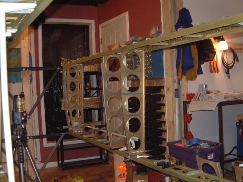

Right wing progress thus far.
