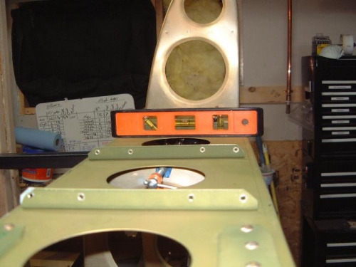

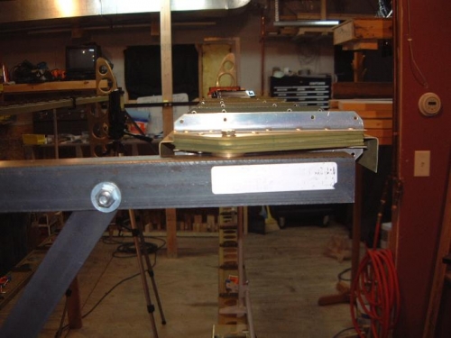

Today I spent some time leveling the main spars. I went to the aviation department of Home Depot and purchased a self-leveling laser level that mounts onto a tripod. I leveled the outboard end of the spar from the top of the spar to the bottom first. I then clamped it to the square steel mounting jig to hold it in place.

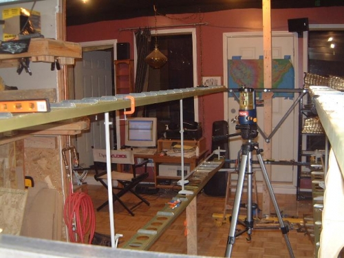

I then set up the laser level and marked a point on the spar flange and measured the inboard end to check for level lengthwise. I then shimmed with washers and rechecked for level. Then repeated the process on the right spar.
The main spars are officially level.
Leveling the outboard left main spar
Leveling the main spar lengthwise
