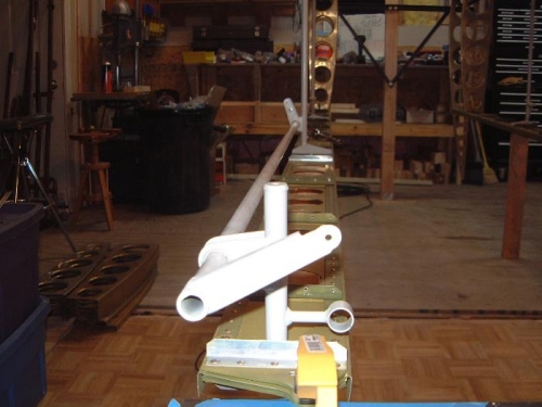

Brief Description:  Sanded and fit flap drive assembly.
Well, I talked via email to Mark Goldberg about the fit of the drive tube into the bearing, He said the bearing was probably out of round due to the welding and I should just sand the inside until it fit. I looked inside and noticed that there was some "slag" (they actually TIG weld and there's no slag) inside from the penetration. I took the dremel tool to the high spots inside the bearings and Voila! the drive tubes fit like a glove.
So I installed the root support and slid the tube in to the outer flap drive support and all is well. It fits and now can be drilled to the spars.
Right flap drive assembly OK to drill.
